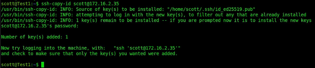

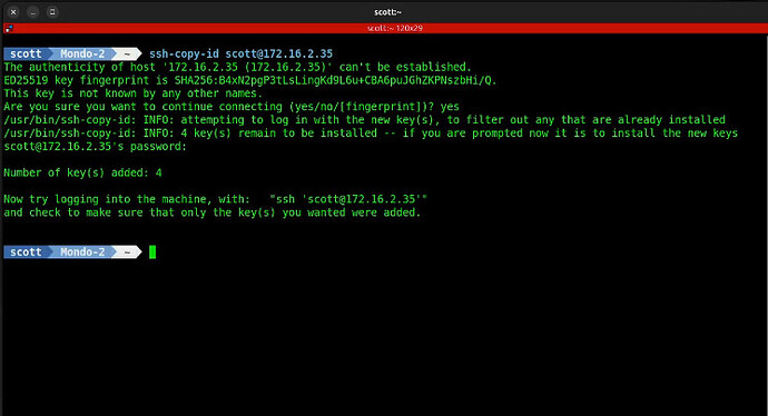

Assuming the key pair exists, it is possible to share your public key with a remote server thus removing the password requirement in the future. As an example:
ssh-copy-id scott@172.16.2.35

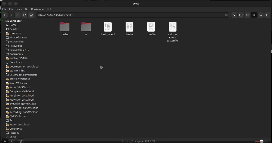

Then, SFTP can be used from my Linux desktop file manager to access the file system on the remote server that has no GUI installed.
This would allow me to drag and drop files from my desktop to the server that has no GUI interface installed.

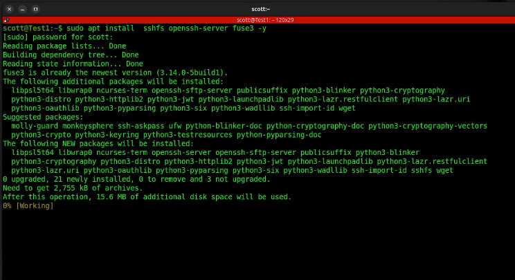

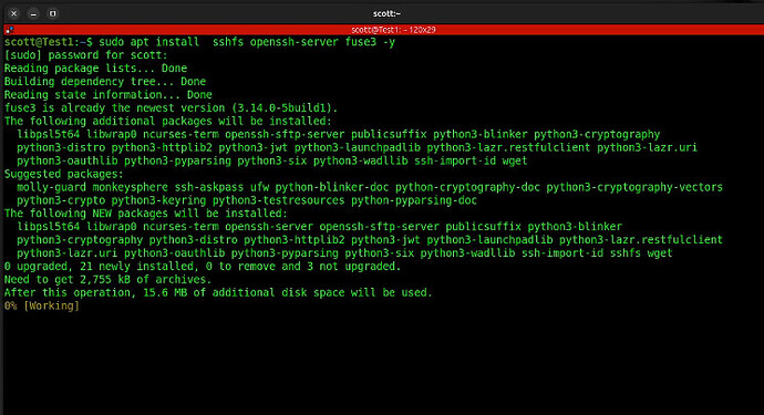

I installed the following on Test1:
sudo apt install sshfs openssh-server fuse3 -y

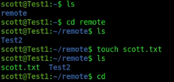

On “Test1” I created a folder to use as a mount point for our sshfs file system on “Test2”.
mkdir -p ~/remote
I sshfs mounted the /home/scott folder on Test2 to this folder and the IP address of Test2 is 172.16.2.35.
sshfs scott@172.16.2.35:/home/scott ~/remote
This will ask us to confirm a host signature the first time we connect and we will be prompted for the password for the scott account on Test2 any time we want to mount the sshfs file system.
From that point you can move into the mount point and access the files on Test2.
cd remote
ls

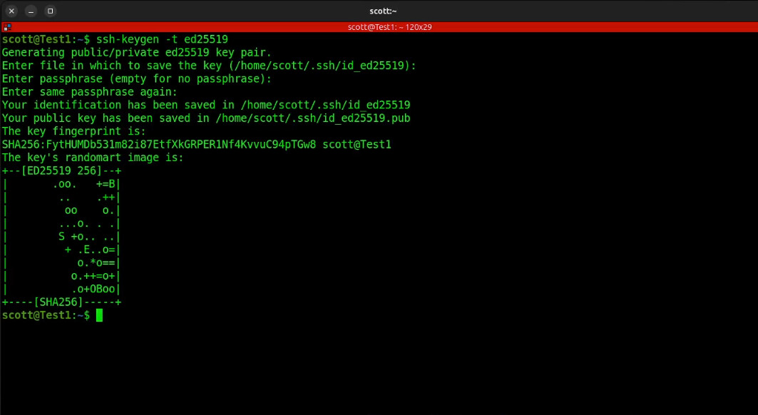

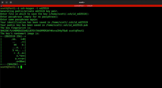

If you want to mount your sshfs volume without providing a password, this can be done by first generating a public and private ssh key pair.
ssh-keygen -t ed25519

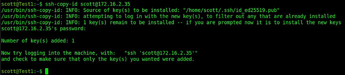

Copy your public key to the remote server.

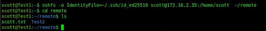

With the key shared to the Test2 server, the mount command becomes:
sshfs -o IdentityFile=~/.ssh/id_ed25519 scott@172.16.2.35:/home/scott  ~/remote
