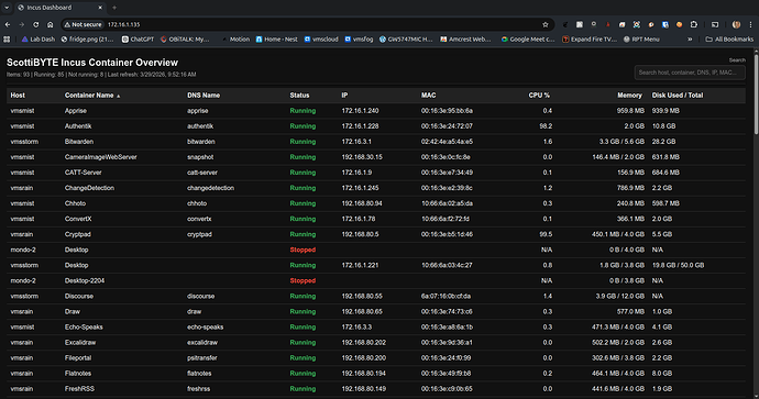

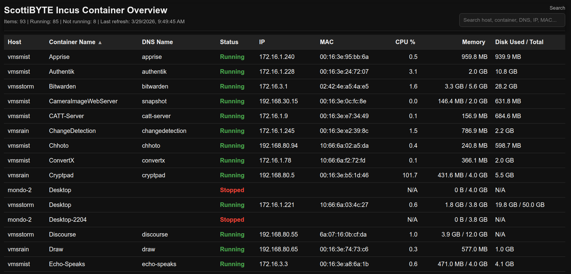

ScottiBYTE Incus Container Utility
I developed a useful Web page using JavaScript to monitor resource usage and status on your Incus containers on one or more Incus servers.
NOTE: One of my subscribers requested a column for memory utilization and I added that in hindsight. I also modified the initial display to sort by the Incus container name rather than by the host name which seems more appropriate.
To host the ScottiBYTE Incus Container Utility, start by creating an Incus container for it on one of your Incus servers.

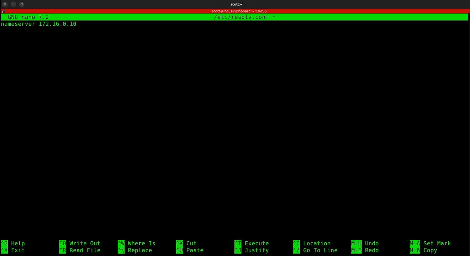

Be sure that you have your Incus server(s) defined with local DNS names on your network. This can easily be done with Pihole and is a requirement for this application.
Remove the symbolic link to the resolv.conf file to support local DNS resolution.
sudo rm /etc/resolv.conf

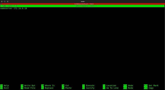

Edit a file by the same name to create a new file.
sudo nano /etc/resolv.conf
Add the address of your local DNS server as follows. My local DNS is 172.16.0.10. Yours will be different.
Do a CTRL O and enter to save the file out and a CTRL X to exit the nano editor.

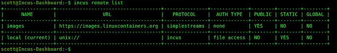

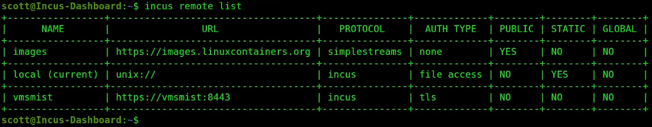

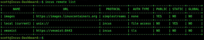

This program works by being able to access the incus servers that you have remote access to manage. You can list these with the command.
incus remote list

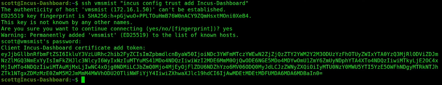

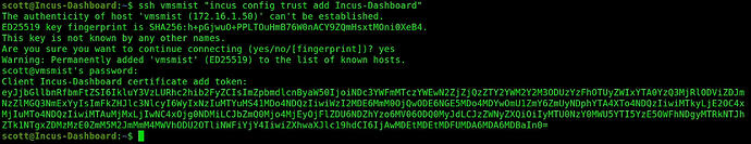

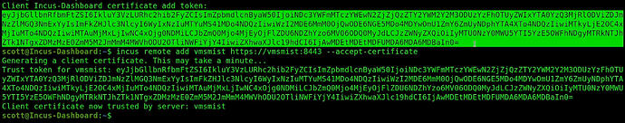

To add a remote incus server that you can manage, we must first get a token. I do this via ssh and so it assumes openssh-server is running on the your incus server and that you have a local dns name for that server. My incus server is named “vmsmist”
ssh vmsmist "incus config trust add Incus-Dashboard"

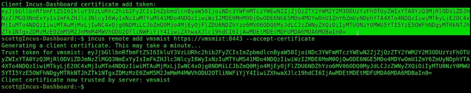

Copy the token that you get back from that command (different from mine above) and then run the following again replacing vmsmist in the two places with the name of your incus server.
incus remote add vmsmist https://vmsmist:8443 --accept-certificate
You will then copy & paste the token you received above.
You can repeat the process above for each Incus server that you have. In the tutorial I did this for two of my Incus servers. Now you can see that vmsmist is listed as a remote server that I can manage.
Now let’s create the code starting with the javascript.
nano server.js
Copy and paste the following code into the editing session.

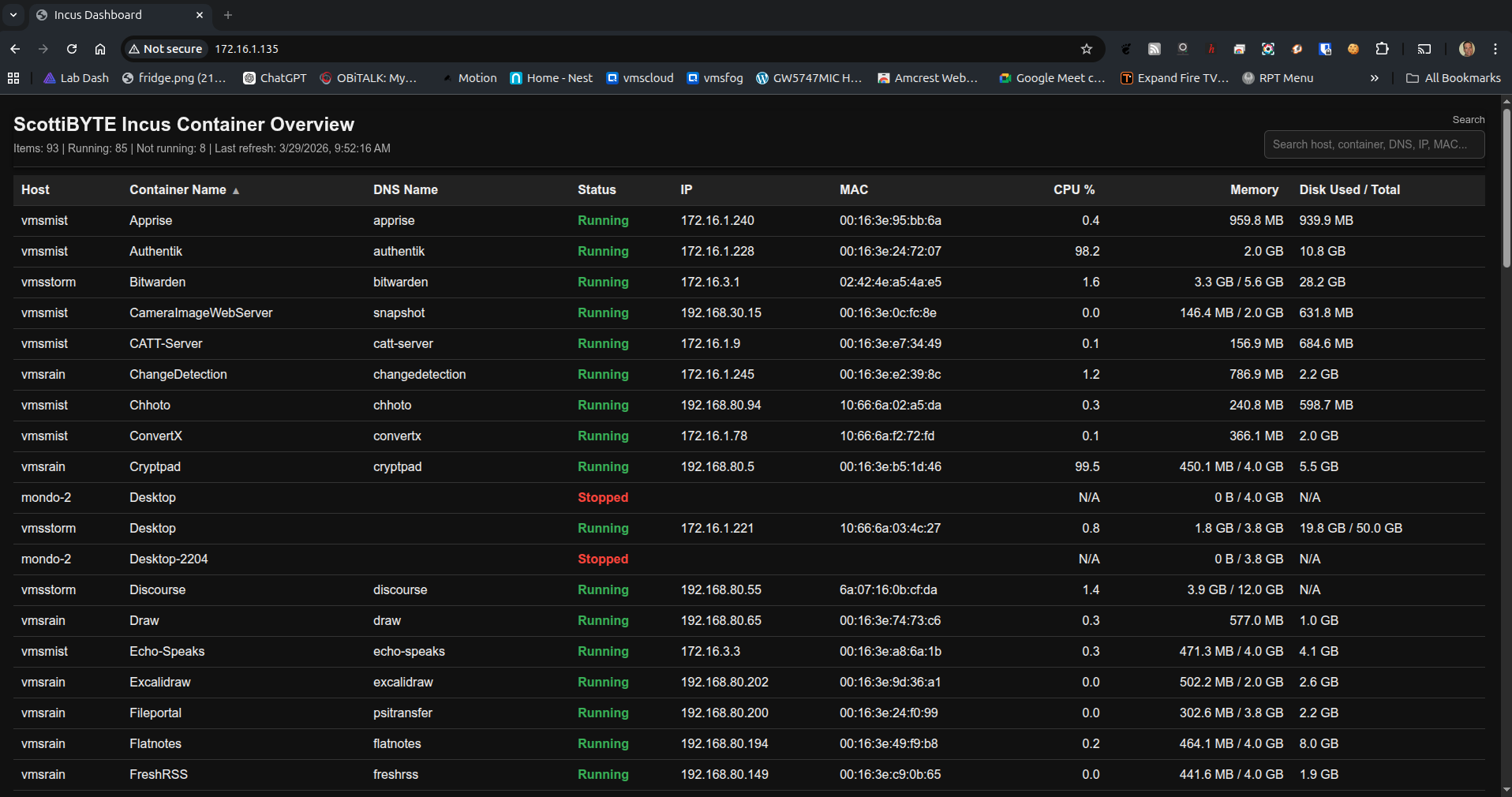

Now create the webpage.
nano index.html
Paste the following into the editor.

<body>
  <div class="header">
    <div class="header-top">
      <div class="header-left">
        <h2>ScottiBYTE Incus Container Overview</h2>
        <div class="meta" id="meta">Loading...</div>
      </div>
      <div class="header-right">
        <label class="search-label" for="searchBox">Search</label>
        <input
          id="searchBox"
          class="search-box"
          type="text"
          placeholder="Search host, container, DNS, IP, MAC..."
          autocomplete="off"
      </div>
    </div>
  </div>
  <table>
    <thead>
      <tr>
        <th data-sort="host">Host<span class="sort-indicator" id="ind-host"></span></th>
        <th data-sort="name">Container Name<span class="sort-indicator" id="ind-name"></span></th>
        <th data-sort="dns_name">DNS Name<span class="sort-indicator" id="ind-dns_name"></span></th>
        <th data-sort="status">Status<span class="sort-indicator" id="ind-status"></span></th>
        <th data-sort="ip">IP<span class="sort-indicator" id="ind-ip"></span></th>
        <th data-sort="mac">MAC<span class="sort-indicator" id="ind-mac"></span></th>
        <th class="right" data-sort="cpu">CPU %<span class="sort-indicator" id="ind-cpu"></span></th>
        <th class="right" data-sort="memory">Memory<span class="sort-indicator" id="ind-memory"></span></th>
        <th data-sort="disk">Disk Used / Total<span class="sort-indicator" id="ind-disk"></span></th>
      </tr>
    </thead>
    <tbody id="table"></tbody>
  </table>

      updateSortIndicators();
      updateMeta(data, filtered.length);
    async function load() {
      try {
        const res = await fetch('/api/containers?_=' + Date.now(), { cache: 'no-store' });
        const payload = await res.json();
        currentData = Array.isArray(payload.containers) ? payload.containers : [];
        window.__lastRefreshText = payload.refreshedAt
          ? new Date(payload.refreshedAt).toLocaleString()
        renderTable(currentData);
      } catch (err) {
        console.error(err);
        document.getElementById('meta').textContent = 'Failed to load dashboard data';
    document.querySelectorAll('th[data-sort]').forEach(th => {
      th.addEventListener('click', () => {
        const key = th.dataset.sort;
        if (currentSort.key === key) {
          currentSort.direction = currentSort.direction === 'asc' ? 'desc' : 'asc';
        } else {
          currentSort.key = key;
          currentSort.direction = (key === 'cpu' || key === 'memory' || key === 'disk') ? 'desc' : 'asc';
    document.getElementById('searchBox').addEventListener('input', (e) => {
      currentSearch = e.target.value.trim().toLowerCase();
    load();
    setInterval(load, 3000);
  </script>
</body>
</html>

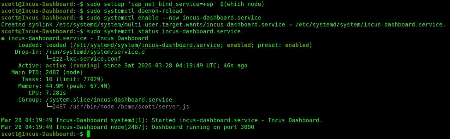

Now create the systemd service to run the application.
sudo nano /etc/systemd/system/incus-dashboard.service
Insert the following making sure to change “scott” in the five places to your username,
[Unit]
Description=Incus Dashboard
After=network-online.target
Wants=network-online.target
[Service]
Type=simple
User=scott
Group=scott
WorkingDirectory=/home/scott
ExecStart=/usr/bin/node /home/scott/server.js
Restart=always
RestartSec=5
Environment=HOME=/home/scott
[Install]
WantedBy=multi-user.target
I changed the default port 3000 for JavaScript to port 80. You need to run the following to allow use of the privileged port 80.
sudo setcap 'cap_net_bind_service=+ep' $(which node)
Reload the service folder to pick up the changes.
sudo systemctl daemon-reload
Define the service to run on reboot and also start it now.
sudo systemctl enable --now incus-dashboard.service
Check the status to see that it is running.
sudo systemctl status incus-dashboard.service

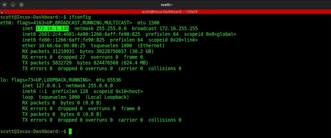

Find out the address of eth0 on your container.
Your address will differ of course.
Go to the address you found for eth0 in your web browser.
You can always go back and add additional new Incus servers to track by following the process above.
